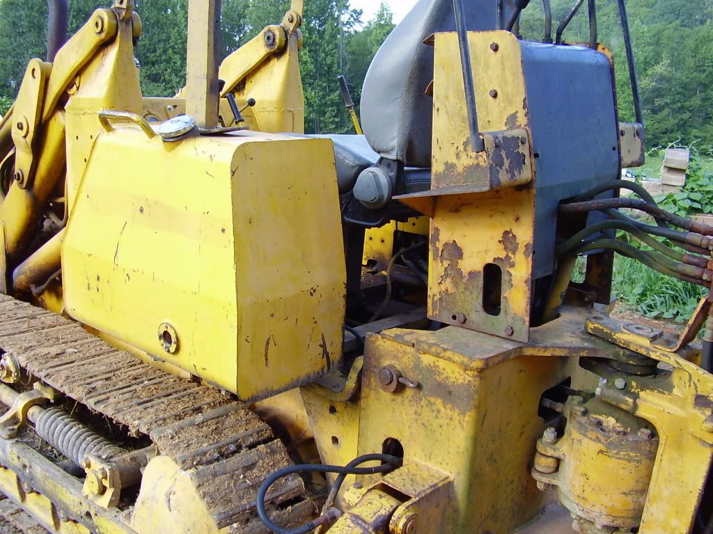

[IMG]http://i1042.photobucket.com/albums/b42 ... 010287.jpgOk, hopefully the photobucket thing will work. If the pictures come through maybe someone can tell what this is. The backhoe has a tag and it starts out with 93, so I assume it is a model 93.
[IMG]http://i1042.photobucket.com/albums/b42 ... 010289.jpgA couple more photos. One of the previous posts pictures shows the track frame mount or adjuster mount with a crack and looks loose. Is this a big problem? Both sides look loose, but only one cracked. Should I try tightening? Breaking bolts? Not going to be running it daily, just "recreational" use.

I would bet that it is an import machine. There are no bolt holes for the fuel tank, so it was born in the configuration it is in now for the most part. On the 450's, they will call them an "A" I believe. My guess is this is a Mannheim crawler, there should be a tag somewhere.
Neat find to say the least. There have been pics of several 450's set up this way, but never seen a 350.

Hi I have one of those import machines. And from your pics I would say you have a 350A machine. In regards to the seat mount, mine is similar except mine has two cylinders( kinda like that hold up a car hood) one on each side to give something like an air ride. I will post pics later dont currently have any. I like my machine being able to run the hoe and run the crawler from the same seat is sooo nice.
