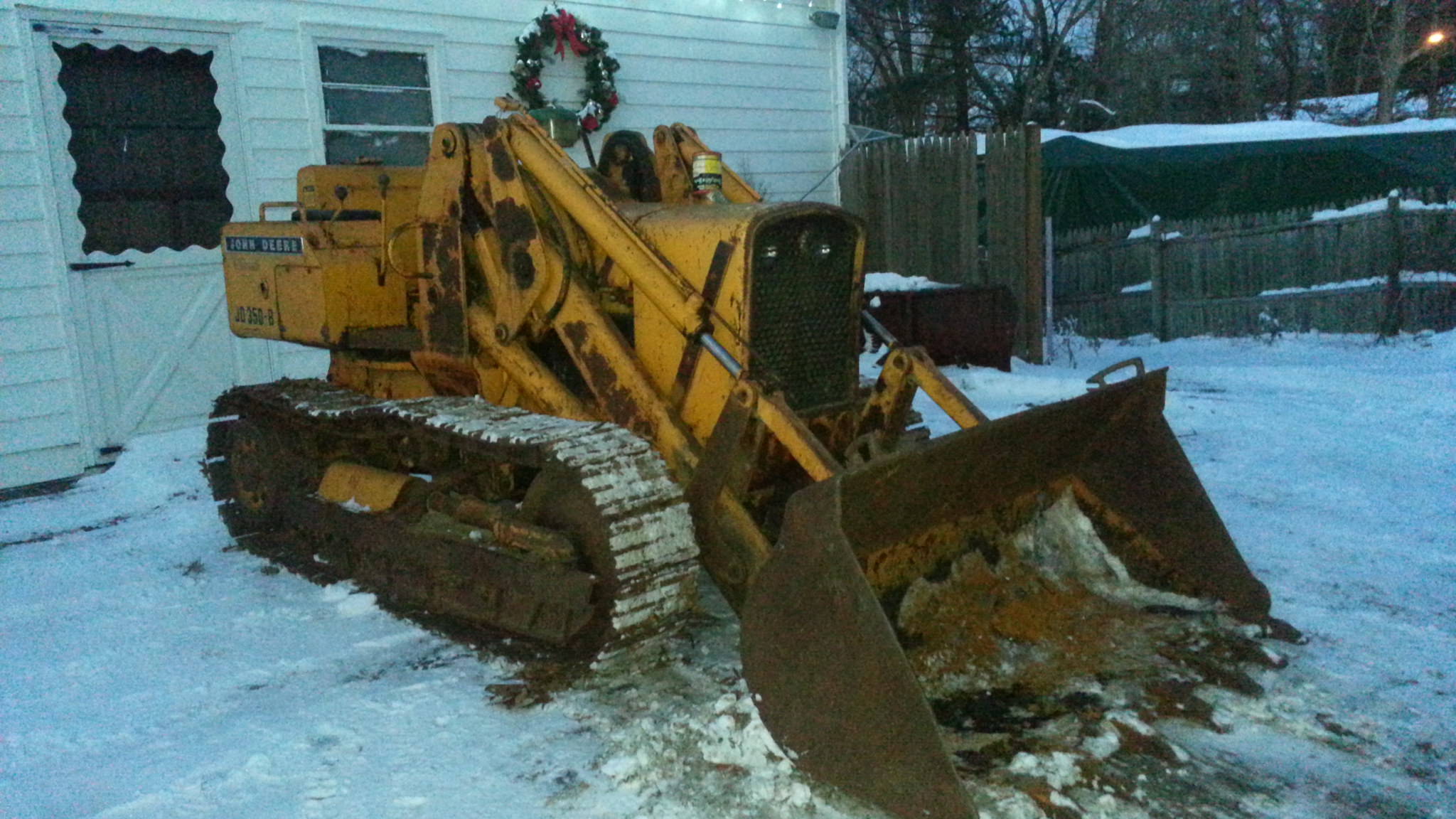

Thanks for the replies - Sorry for the late reply - I was tied up with work. I am going to make two supports out of 4" angle iron. Just to be sure, I got a 2 ton tall stand to put under the cross member of the loader arms. (over-developed sense of self-preservation, I guess). Still trying to figure out how to post a picture. Looks like it has to be posted eslewhere with a link. I'll try this: Image

Pretty good looking machine and it's backed up to the back door for a quick get a way! Good thinking.
