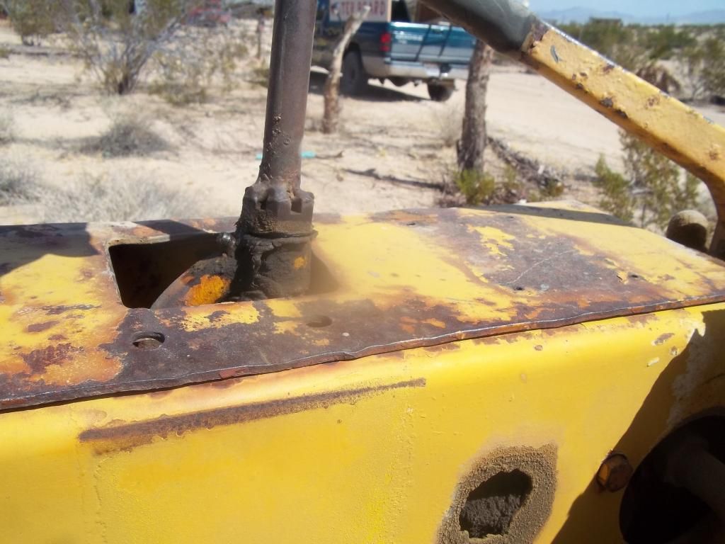

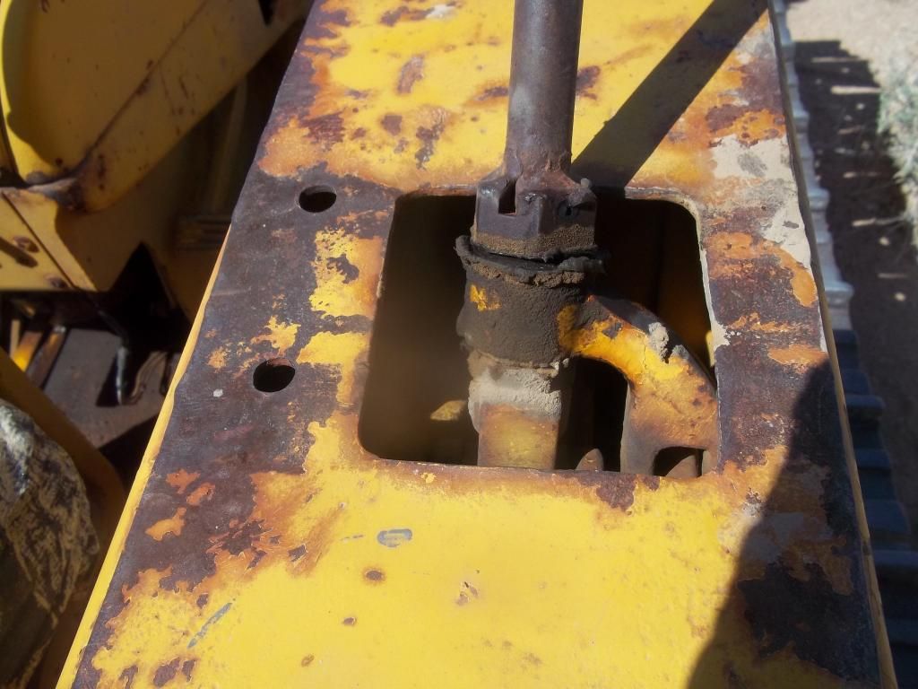

Post by jtrichard » Sat Sep 06, 2014 11:59 pm
here are some mods my dad made to our 2010 linkage put Zerk in and added stop on "T" handle which was done on later JD's... made a world of difference for less wear and less slop he used a nut ...JD used a washer on the handle... looks like there was something on your "T" handle that was removed?..Image

Post by jthornton » Sun Sep 07, 2014 5:34 am
If your talking about the brazed spot, someone brazed it up to try and fill the gap of the worn out bushing. I turned the brazing down to the original diameter so it would fit the new bushing.
