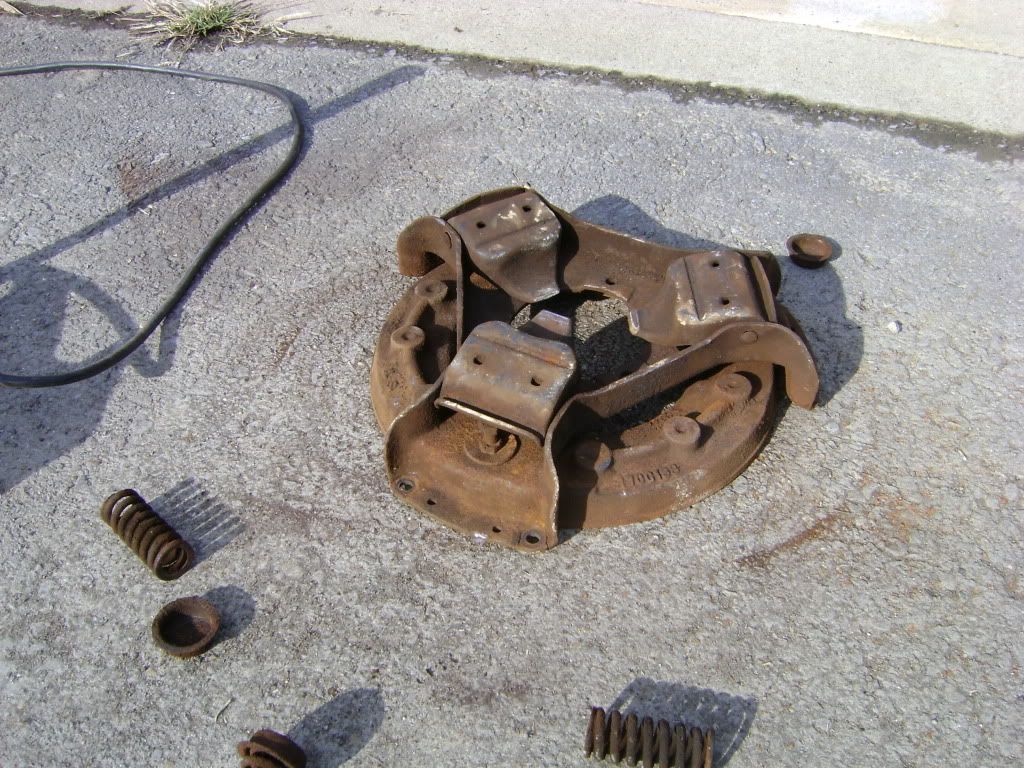

This shade tree mechanic has successfully removed and installed the left steering clutch of my (approximately 1970 model) 450 crawler. Advice in this thread is all good. I got the track off without removing the master link. I broke a socket and bent a 1 1/8 inch wrench getting the sprocket lugs off, needing a 6 foot pipe for added leverage. The main message I would like to convey is that my clutch did not seem to be worn in the usual sense, rather it seemed to be suffering from improper installation.

The pressure plate moves opposite to the throwout bearing. Actuating the clutch lever moves the bearing outboard, and the pressure plate inboard. In-between are 3 actuators on a fulcrum. The amount of pressure imposed by the pressure plate against the 8 layers of clutch is adjustable by a 1/2 inch bolt that is accessable through the steering clutch cover. backing this bolt out will compress the springs more and add pressure, possibly restoring clutch function without removing the clutch. But if you back it out too far, the actuator will fail, take it from me. I had to get two welded after they cracked.
I could not have restored my clutch function in this manner (without removing it) mostly because the referenced bolts were seized and they broke rather than turn. I had to drill out the stud and clean out remaining threads with a tap. I really don't think I could have done that with the clutch installed due to space limitations.
I mentioned an improper installation. The problem refers again to the bolt on the pressure plate mentioned above, which you will find has a nut threaded to it to hold its position. Somebody had put a large washer under the stop nut, which, in turn, did not allow the pressure plate to move outboard when the steering lever was released. Only one of 3 bolts had the over-sized washer; the other two actuators were enough for it to work for a while, but ultimately this one limited the movement of the entire clutch.
