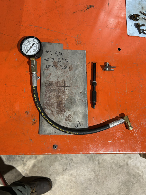

Decided to replace the injectors (went with Stanadyne) on my 67 JD 350 Straight and while I was at it, I did a compression test. The Service Manual says that the minimum is 300 psi and all should be within 50 psi of each other.
I did adjust the valves prior to the compression test; one was tight and several were quite loose. Would have been interesting to do the compression test before and after valve adjustment to see if I gained any compression, but I just did it afterwards.
I ended up with 400, 390, and 380, which is well above the minimum, but I'm not sure what reading you get on a low-hour engine.
Anyone else have their numbers?

Your numbers are great dude! A brand new engine might be a bit higher PSI than what you have but it wouldn't be much. And even then once it breaks in they would settle to about what you have. Looks good to me!!

Are you having any issues with the engine?
those numbers look good, but how is the engine working?

It does not run great at low rpm. Hopefully the new injectors and freshly adjusted valves will clear that up. I also need to check the timing on the injection pump; haven't done that yet.
