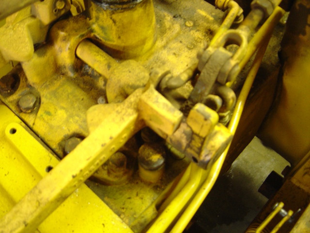

I hate to sound like a dipstick myself, but I can't find the one in my '65 straight 350. Last winter I had a freeze up that I think is because I have H2O in the tranny. I want to check before I change but can't find the stick. It's a 4 speed w/ reverse, not a reverser. Can anyone help me?

should be a round tube on the top left side of the transmission itself. pretty close to the hourmeter. Theres a cutout in the floor to get to it

Okay, I took the entire floor plates out and can't find a dipstick. there was a cutout in the floor next to the hour meter but it was a blank spot on the tranny. Could this be a case where I need to take a bolt out and just check level by sight? Again, any more input would be appreciated.

hello, i believe its under the left hand steering clutch lever like the 1010s.

This is an old pic i found of my 350C looking to the back of the machune .Its the little round guy next to the steering lever. Im pretty sure the straight 350s had the dipstick near the same location.[/img]

I can't thank you enough for that picture! Found it! It looked to bethe stop post to the engage lever to the winch in the back. Scraped a bit of paint and there was the seam right before my eyes.
Now the fluid is as milky as can be so it needs to get out of there. When I drain, how do I get most of it out of there? I read that you can put fuel in to help but do I do this before or after I drain? Do I try and run it churning the mix around to get more out or will that do damage?
