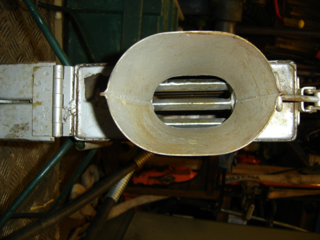

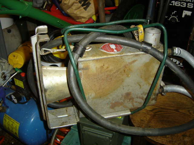

Well I couldn´t help it but I just stumbled on a piece of old army diesel engine preheater today and bought it. At $14 it was to good to miss.
This one uses an old type of ethanol burner that is placed in front of it with quick connectors that attaches to whatever pipe you´ve got hooked up to the engine.
I´ll see if I can get a picture posted here during the weekend.
BR/Fred
Well here´s the pic´s, I think.....
At $20 it was okay since I´ve already got the ethanol burner that should be in front of it. If I don´t use the propane torch instead.
The only question now is where to put in the T-piece for the quick connectors.
Any ideas??
BR/Fred

If you have a Hot Box or Wedge heater then set it up with large hydraulic quick couplers and good hoses .We have one for the Wolfe plows and never use it .It came on a cart and had its own battery and fuel tank It came with wheels and I changed it over to small skis with tips on both ways to get around neither work worth a darned across a plowed field but skis hold up better and the unit is not that heavy to get around .Worst case two men carry it with ease .We got some severe cold weather up a few years ago and used it to start even our oppositions trucks and equipment .Digitup.
