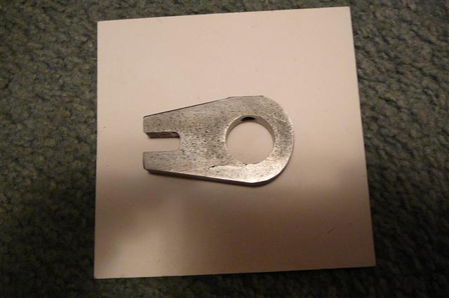

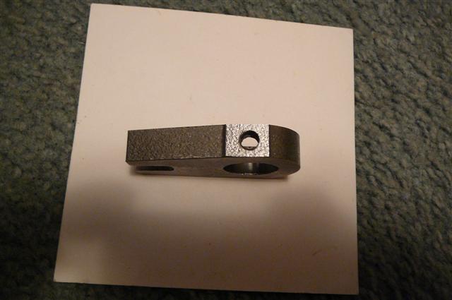

I think I figured out the problem with my reverser. As you can see in the very first picture in this post, the clutch lever is worn. I guess it was approx 3/32 of an inch groove that was worn out in the lever. This was not allowing the clutch valve to fully open when the clutch was released. I tried welding up the groove and machining back out, but could never get it to operate smoothly, so I decided to just make a new one. It is not an exact match, but when installed, the clutch operates very smoothly and is traveling full stroke. Hopefully when all the parts arrive and I get it back together it will let me build full pressure in the reverser. I still have a lot of other things to fix and will be asking more questions as I go along. Here is a pic of the new clutch lever. Deere wanted $132.00 for a new one. This was milled from a piece of 1/2 inch steel I had laying around.

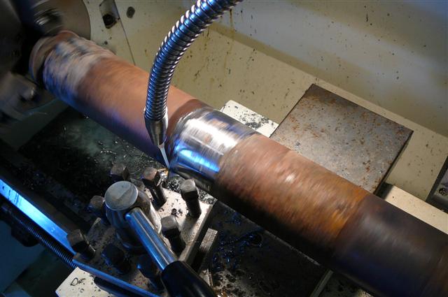

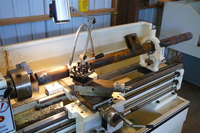

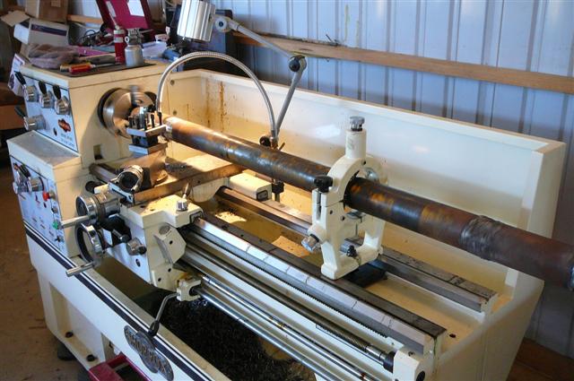

Here is a pic of the rear crossbar being turned after welding up the worn areas. Will be posting more pics later. The reverser rebuild has turned into a complete crawler rebuild almost. Anyway I am having fun and learning alot about these crawlers.

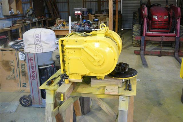

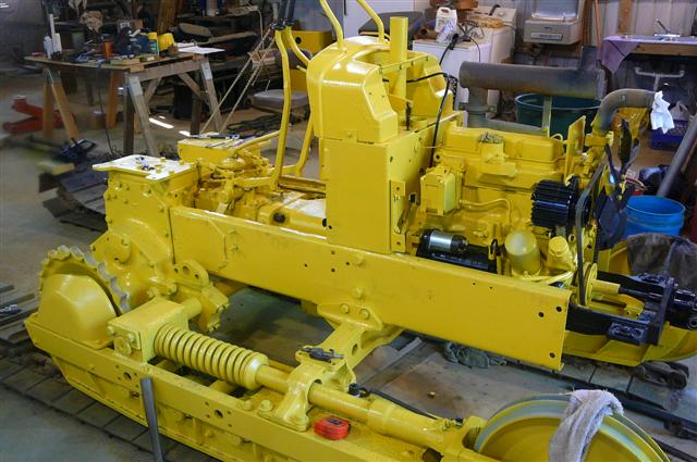

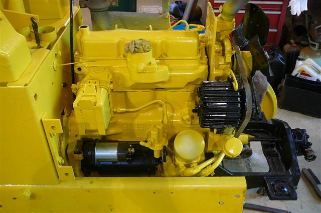

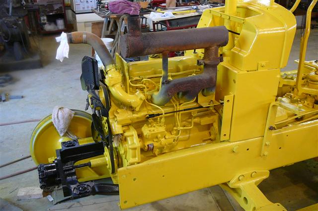

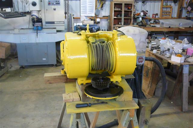

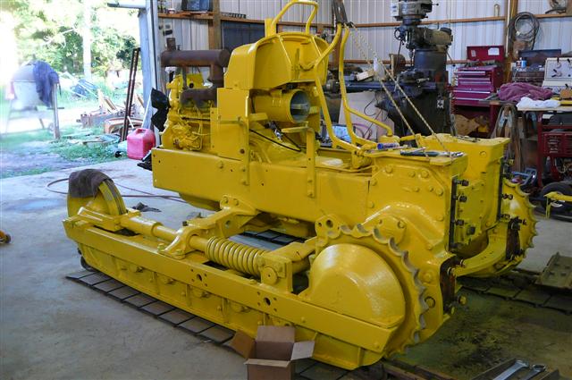

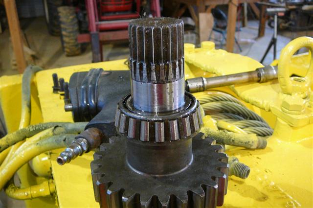

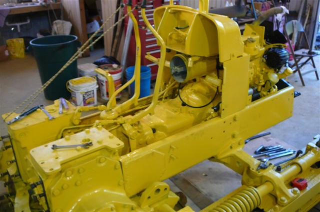

Haven't had time to post any pics lately so I took some time today to take a few pics of my progress. It has been a lot of work and it is still not ready but getting closer. It will not be like new when finished but it will be a thousand times better than it was. So far I have replaced all the piston rings and rubber washers in the reverser pistons, all new seals and gaskets in the reverser, all new seals and gaskets in the hydraulic valve body and a new clutch piston and clutch arm that I made seen in earlier pics. Couldn't figure out how to connect a drill motor to the reverser input shaft so I am still hoping the clutch arm was the problem. I have welded up the worn areas on the rear crossmember and welded and ground out the mounting holes for it on the track frames. That was a lot of welding, turning and grinding. I welded up the worn bolt holes on the front crossmember and machined them back out and made new busings for all bolts. Everything looks good. I pulled the winch off because the input shaft seal had worn a groove in the shaft and it would not hold oil. I welded it up and turned it down and it is now holding oil. The input splines are worn pretty bad but should be ok for occasional use. Hopefully next weekend I will be able to crank it up and check the reverser. I will be highly disappointed if that wasn't the problem. Next major task will be replacing all the worn tilt componets on the blade and blade frame and new bushingand pins for the pivot joints. I am really dreading that. Will be alot of cutting and burning involved. Anyway here are a few pics to look at.

Just a quick note to update everyone following this thread. Haven't had a whole lot of time to work on the crawler lately, but I have got it to the point that I can start it. After having the engine out for about three months, it turned over maybe twice and fired right up. After letting it run for a few minutes, checked the pressure on the reverser and it was reading right at 120psi. It looks like the worn clutch arm in the first pictures was the problem after all. I still have a lot of work to do, but it should have power when I get finished. I will try to post some more pics soon. Thanks to all who have replied. This forum is a very valuable tool and the people here are very valuable resources. Again thanks for all the help up to this point.
