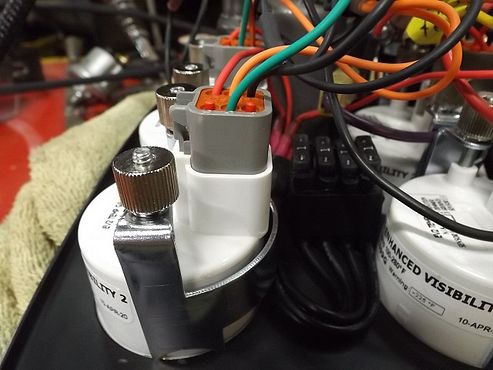

Well I wanted to post a follow up. My Stewart Warner gauges have failed. The IGN post was grounding out to the dash and only when the terminal nut was tight. That kept me busy for a bit to find that. With yet another set of gauges with crooked faces crimped in position, I decided that I am done with S/W gauges. Their quality has tanked and they are to much trouble for the money.
Having used Isspro before and not having one issue ever, I decided to see what they had. I ended up talking with Don at Isspro at their Portland Oregon office. I ended up with their EV2 sealed gauges and despite being double the costs of the S/W gauges, I know it was a painful but good choice. The EV2 sealed gauges will work under water and that is how they display them at SEMA and other conventions. These gauges come with a small red warning light in the bottom with a programmable set point for when they turn on.
The tool to set them is 68 bucks but Don saved me the expense by discussing each gauge with me on the phone and deciding on a set point for each one. I received them and took the time to install them in the dash panel on the bench. I was held up by a lost order for the woven wire loom that just arrived. I had used up all the small stuff on my new wire harness. The post office lost my order for two weeks. It is now here. I can now shorten the sender leads and get it in the crawler. I ordered these gauges nearly a month ago and yesterday Don called me to ask how I liked them. Now THAT is customer service. I decided to update this build with what happened to my gauge set and post up my experience with Isspro. I need to change the sending units and land the dash panel. I will post a picture of the gauges and what they look like shortly. The quality is top notch and worth every penny. They will never fog, they are totally sealed and will tell me with a warning light if things get to warm. The crawler has been down since moving it outside. It will be nice to be done and use it here.

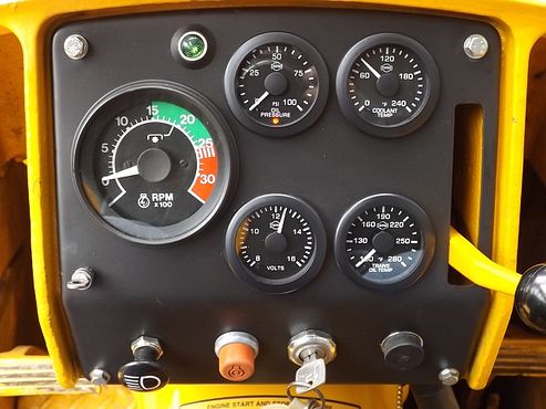

I finally got to use my crawler after a full winter of rebuilding everything forward of the key switch. The motor did not even get a full revolution before firing off. It purrs and is amazing compared to what it used to do. After a pretty disappointing experience (again) with Stewart Warner I can say the replacement isspro gauges are as good as it gets short of something from an aircraft. I changed the sending units out and got all of the gauges hooked up. Everything works as it should. I am pretty pleased with them. I loaded the motor up by removing the top 10 inches of part of a field that needed lowering for snow melt drainage. It probably still needs to work for a full break in. I will get to that later when the ground dries up some. It's muddy.

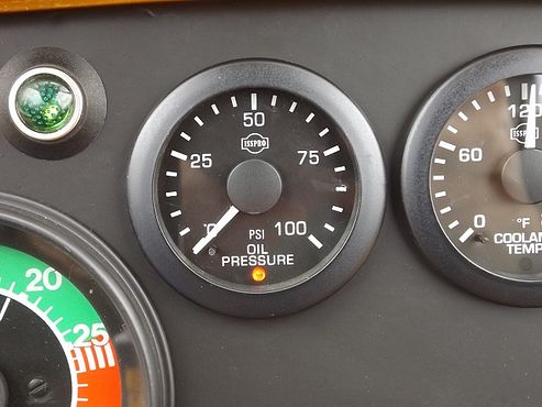

So here are the gauges. They look great and work great. The green indicator to the left of the oil pressure is on with the battery switch. To remind me to hit the switch.
The warning light from no oil pressure as the engine was off. Each gauge has one except the volt meter.
The gauges are sealed completely and will work under water. The back side plug.
As mentioned Don from Isspro called a week ago to see how I like them. No one does that anymore. They were expensive, and knowing I will probably never need to replace them ever again, worth it in my opinion. So Don at Isspro in Portland Oregon is who to call. Now to get after an idler replacement and eventually the brakes and most likely steering clutches. Everything works but one brake is spongy. Maybe next winter.
Thanks to everyone that helped with this major repair. I learned a lot.
