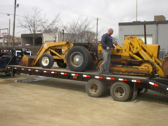

Post by real550A » Tue Apr 15, 2008 8:01 pm
Here's a pic of moving day. I felt sorry for both of these orphans, and
brought 'em home.
