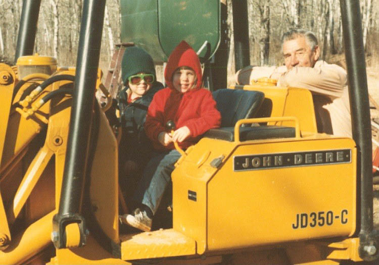

Post by srs_mn » Thu May 14, 2009 4:07 pm
Paul45 wrote: I wish someone with a cage for a 350 would take some good detailed pictures of their machine and post them. I mean good pics of the mounts and attachments points. HINT HINT?
This way i could fab. my own up.
Hi Paul45,
Here's an old pic of my son, niece, and dad admiring the ROPS attachment points on my BRAND-NEW 1980 350C...
I hope you can get some ideas from it.

There is a big difference between the FOPS (falling object protective structure) or protective canopy and a true ROPS.
What I have been seeing on ebay are protective canopies, not ROPS. They are not heavy enough to protect the operator in the event of a roll over.
Look at the difference in the vertical tubes in the above two examples. I'd say the loader has a ROPS, the dozer has a FOPS.
