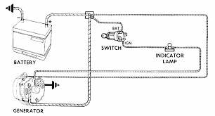

When you say it is a 3 wire alternator, you mean it has an internal regulator and the plug on the side looks like this:

When you look at it, one of the 2 wires it has is larger than the other. Take this wire and bolt it under the post terminal on the alternator that also goes to the battery. This just leaves you with the one skinny wire. This wire goes to the accessory terminal on your ignition switch, even easier is to find the original alternator wire that energizes with the ignition and just connect it to that one. A word of warning here- this wire becomes energized when the alternator is spinning so you cannot wire it into the ignition circuit unless you have a manual cutoff, as when you turn off the key it keeps the circuit energized and the engine will keep running until you disconnect it. If you have no other way, you can run it through a light bulb which reduces the current but I did not need to for mine. Wired like this, it should not drain the battery at all.

Exactly how i wired it and used the same pigtail. I did have the full-field issue as well and would not shut off so had to use the accessory stud on the ignition switch.MarkW wrote:When you say it is a 3 wire alternator, you mean it has an internal regulator and the plug on the side looks like this:
