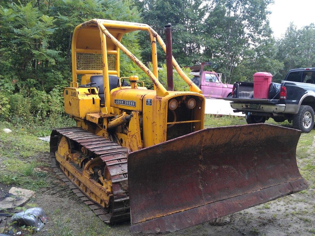

Here are a couple that I do have now just to show them off !

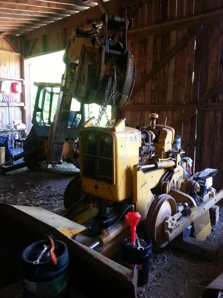

I have my newer 450 completely taken down so the transmission is sticking out the back. I gouged the Crack and am supporting it w a bottle jack. I have taken a cold weld approach using a Lincoln sp-115 might with gold gas. Very light quick beads followed by peening for about 10 seconds. So far the project is going well but time is getting to be a factor plus I will need an under carriage.

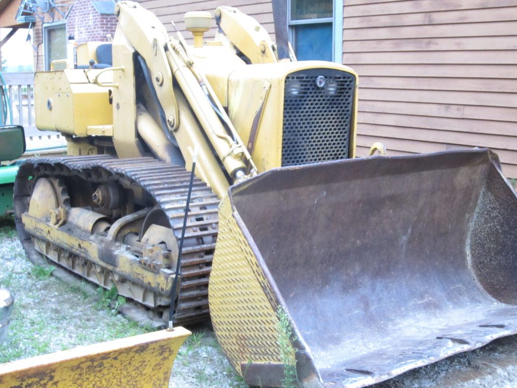

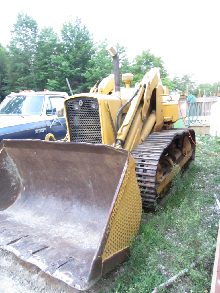

So fast forward to my bucket 450c. It has been sitting for 2 years. Fired right up the other day and ran great aside from the hole in the radiator. I'm in process of replacing the radiator.

My biggest problem is i'm kind of stuck between both machines.
The 78 with the 6 way blade has the cracked trans, but the under carriage is also shot. All rollers, tracks, chains, and steering clutches will require replacement as well. So, i'm looking at finishing up the weld job and hope it works(i too am confident if you take your time, the weld will be fine). Then I have to get a loan LOL to put a new under carriage in or disassemble the older bucket crawler and bolt everything up on the 78.
OR
If the radiator fixes the over heating issue on the bucket crawler, then I have a good running, 90% under carriage(not sure of steering yet) machine that is ready to go aside from the need for the 6 way blade. I lose the turbo but I think it's going to save me a ton of time in the end game if the 6 way can bolt up to it.
Then I can part out the other machine to poor souls like myself lol.
Thoughts? again..... Still wondering if anyone knows if the 6 way will "bolt up" to the loader crawler?
