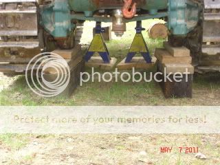

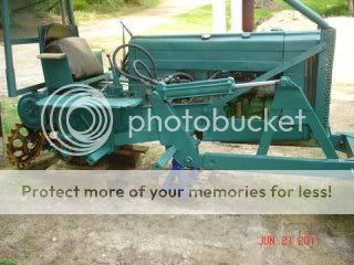

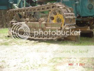

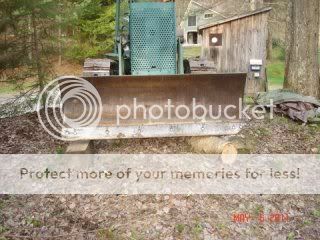

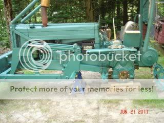

Hi: When I asked this question, I got a few different answers, but the one I liked was to back up a bit on a crosswise 4x4, then block tight under the final drive pans, then put a block under the bucket/blade and lift the front end and then put blocks or safety stands under the front cross member and lower until solid.
I did this to rebuild my undercarriage a few years ago and it worked well. Safe, quick and inexpensive. Let safety be you guide. You probably won't have to go as deep into your undercarriage as I did. My jack stands are on 2x12 pads.

Thanks so much for the photos, I'm slow and safe at all times. So back up on the 4x4's so it is under the sprocket and has lifted the rear?
JT
Posts: 993
Post by Paul Buhler » Wed Feb 05, 2014 10:34 pm
You've got the idea. By backing onto the 4x4, you lift the rear end at an angle and raise the pans or a rear cross member high enough so that you can block under them. When you block the bucket and use down pressure, you then lift the front end of the machine and the 4x4 is now clear and the tracks can spin free of the ground. When I caulked tracks in the past, this was all that was needed to spin the tracks and do the welding. In your case, you'll need to release the track and get as much clearance as needed to drop out the roll - you may still need to split the track, but I'm not sure. Good luck
