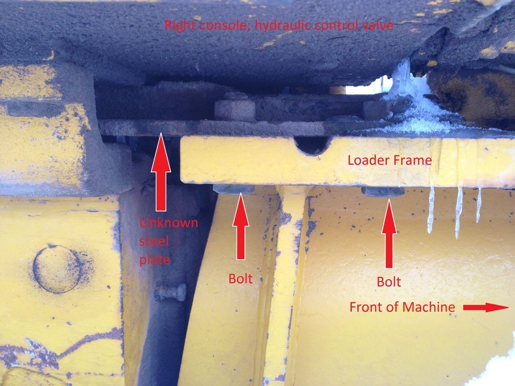

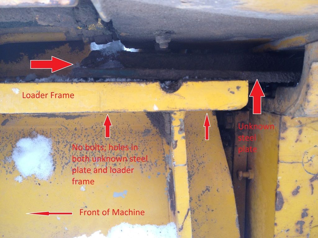

Hi all. I hope someone can help me out here on two unknown steel plates I noticed on a 450C loader that I was looking at today. The plate is on both sides of the machine below the battery box and below the hyd control valve compartment. Appears to bolt to loader frame and rear housing. Anyone know why these steel plates are supposed to be there???

Post by jtrichard » Sat Jan 24, 2015 7:36 pm
what is on the rear of the machine? the hoe/ripper bracket comes up and hooks to the loader frame at that point ... a pin goes in that half round and in the upper bracket to locate/lock in place what ever those plates are on yours is i dont know what is on the other end of the plates?? pics???

Post by jgbanshee » Sat Jan 24, 2015 7:46 pm
The particular machine has nothing on the back. There is a hitch, counterweight and PTO. That makes sense though say for a backhoe to tie into the loader mount but I would assume the steel to be thicker for a backhoe.

Post by jgbanshee » Sat Jan 24, 2015 7:56 pm
The rear bracket is probably what it is minus the fact that it was probably torched at one point because the j-brackets are not there.
Post by jtrichard » Sat Jan 24, 2015 8:11 pm
those steel plates are NOT JD.... looks like something home made was mounted on the back at some time

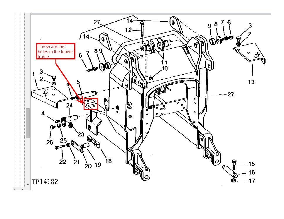

Post by DrLoch » Sun Jan 25, 2015 6:37 am
My 450C has similar JD plates mounted like that. Mine has/had a ripper on the back. The 2nd picture is exactly what is on the rear of mine. The previous owners of of mine torched off the ripper section and welded in a 4 x 4 box frame of sorts with a mobile/prefab ball welded to it. They used the machine to clear the lad and then move the home into position. My guess is that the keys, #2 were used to help lock in the rear bracket with the loader frame. I've not seen a loader with a hoe attachment which is what may be the purpose of the bracket assy.
As jrichards added, that frame that is added is not JD. I can get a picture of mine if it would help in any way.

Post by SEAL » Fri Feb 13, 2015 10:38 am
My 450 has a backhoe mounted on it and those holes and a steel pin in that groove between the bolts is for the front of the backhoe mounting brackets. My brackets are separate, as in a right and left bracket, and are not attached to each other. Each bracket in addition to those 2 front holes has 9 more holes in the back of the steering clutch housings. Hope this helps.
