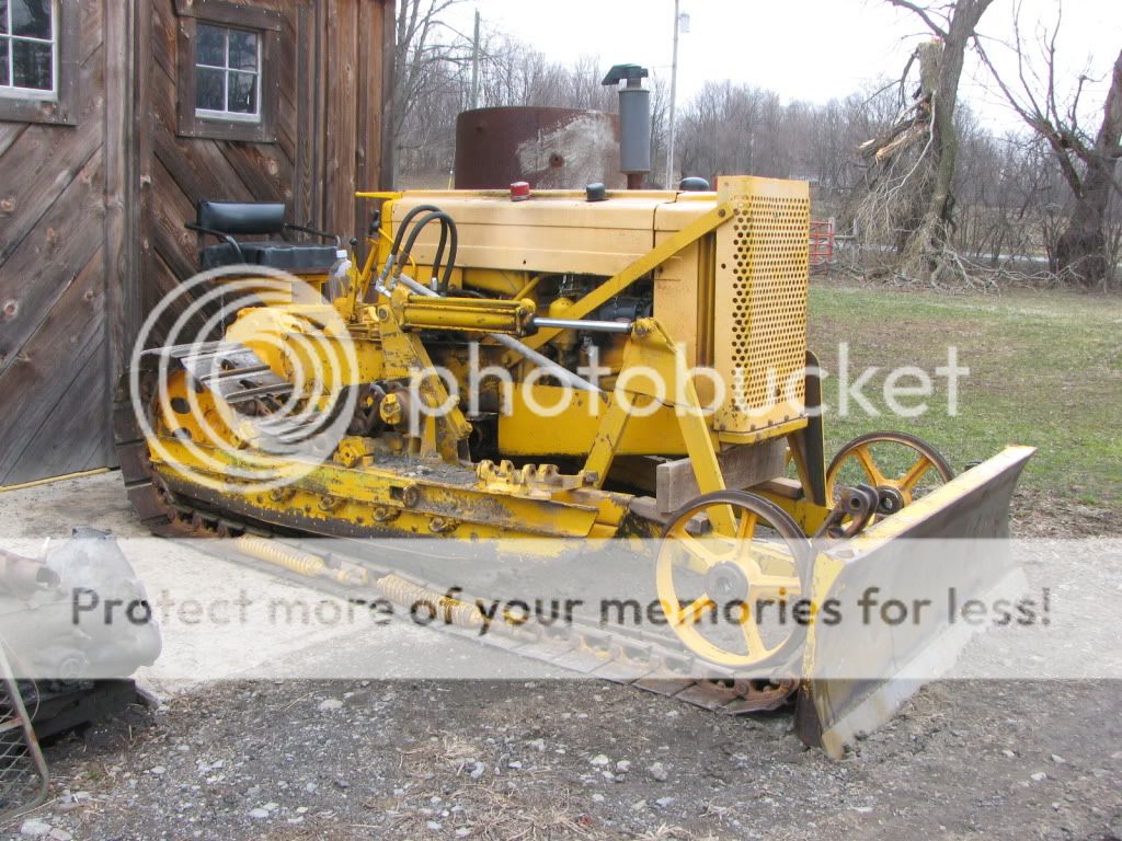

6x6 blocks under each side of the drawbar support, and the front held up by the blade and blocked as shown.
Did not even need a jack, just raise the front, slip a 2x4 under the center rollers, raise blade to tip machine forward, blocks under the back, then raise the whole machine off the ground with the blade.

Tracks are off. Thanks for the help - I used bits of everyone's thinking.
Used 4x4 blocks under the tracks to lift the rear. Blocked under the finals then lifted the dozer with the blade on 12" high blocks, which freed the 4x4s and allowed jack stands to be placed under the front cross bar. Lowered the machine onto the jack stands - nice and solid. Spun tracks, loosened tension and removed master pins at the idler end. Found that I could "back off" the tracks one side at a time - they flopped off to the rear without incident - easy and sure saved a lot of lifting. They'll be off to the pressman this week I hope. Now I can play with the frames, bad roll(s), and replace one front idler.
