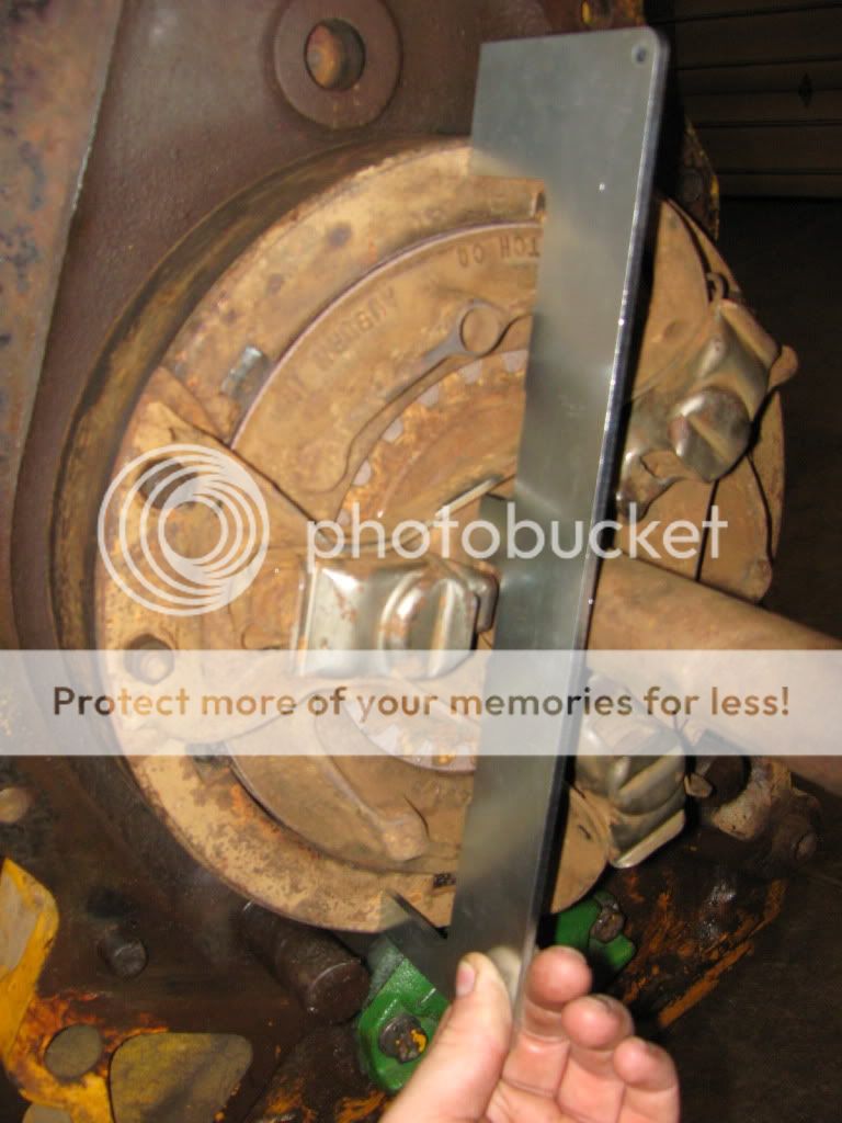

Ok i know that this is a dumb question but hang with me i am learning. this is my first crawler and am learning. ok so how do you go about setting the fingers on the steering clutch pressure plate. i have replaced the fiber disk and the steel disk and am ready to bolt up the new pressure plate. where do i go from there?? thanks Brad
Post by Ray III » Tue Sep 08, 2009 6:07 am
Bolt the pressure plate on and adjust the bolts under the levers so the fingers match the gauge when positioned as shown.
The tab that sticks out is for setting the engine clutch.
