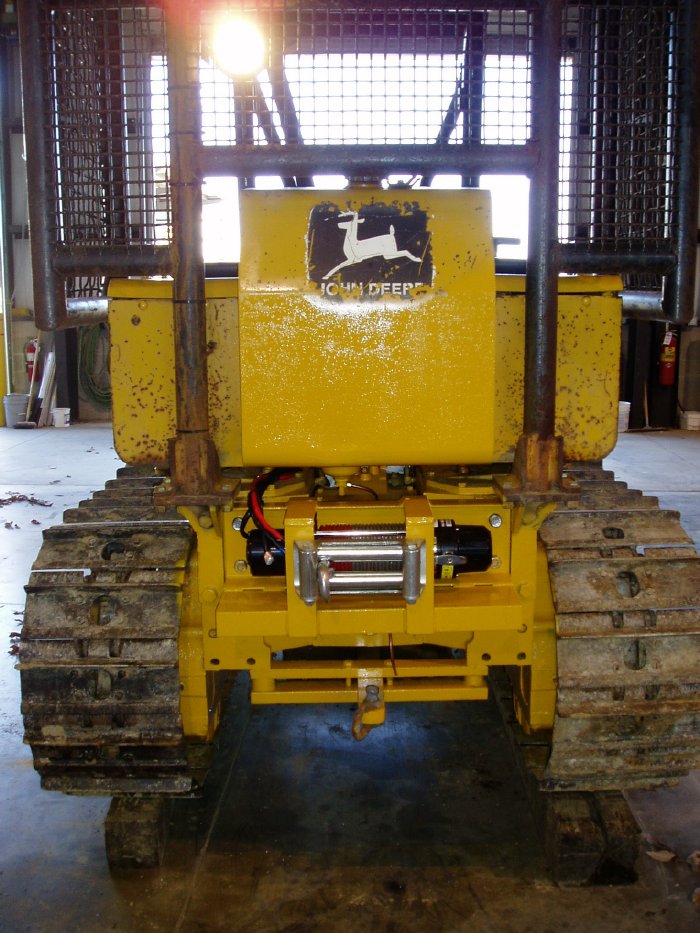

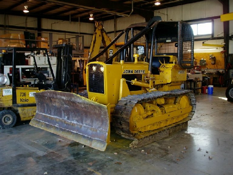

Finally finished prepping our new 450C.
New filters, fluids, some hoses, packing, frame pins, etc.
A little paint.

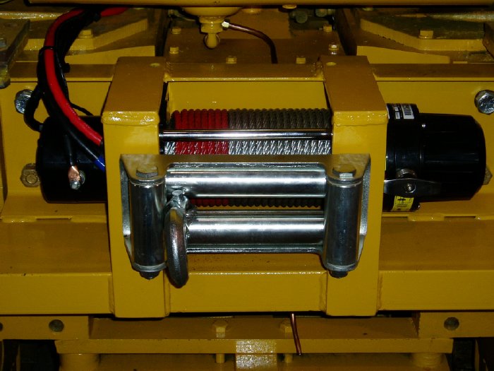

Our shop mechanic fashioned a frame for a 6,000 LB electric winch to do some light log pulling.

Post by K LeClair » Thu Oct 25, 2007 5:00 am
Nice clean job on that winch!
I love to see fabbed equipment that is clean and presentable. (unlike my 1010 winch)That 450 is sweeeeet.

Ditto on the winch!
I would be interested in hearing from you in the future on how well that winch works for you in the field. I have a 2010 loader that has a backhoe attachment so I wouldn't want to install a winch permanently but it would be nice to mount an electric winch on a removable bracket for log pulling, like you say.
