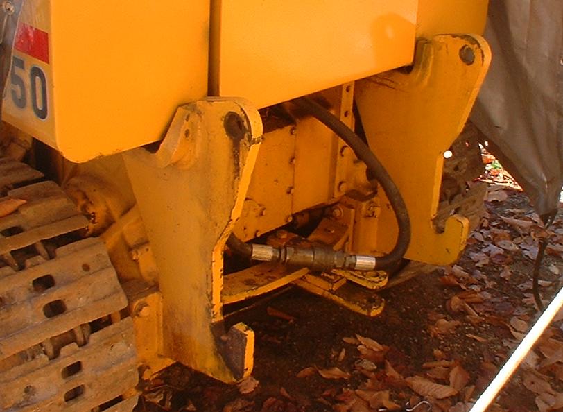

Here is what the mounts for a 93A/95 hoe look like on my 350. The hydraulic lines/couplers attach to a similar set on the hoe. The hoe has two fixed pins that go in the bottom "hooks" and two removeable pins for the top holes. As you might imagine, these mounts are heavy being made out of 1" thick plate steel.
