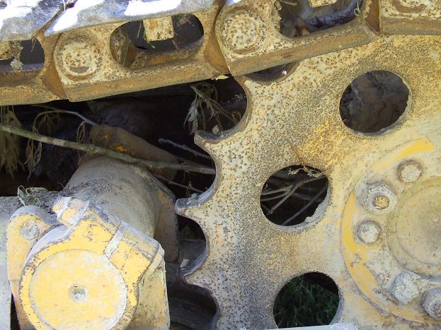

This is the left side sprocket.

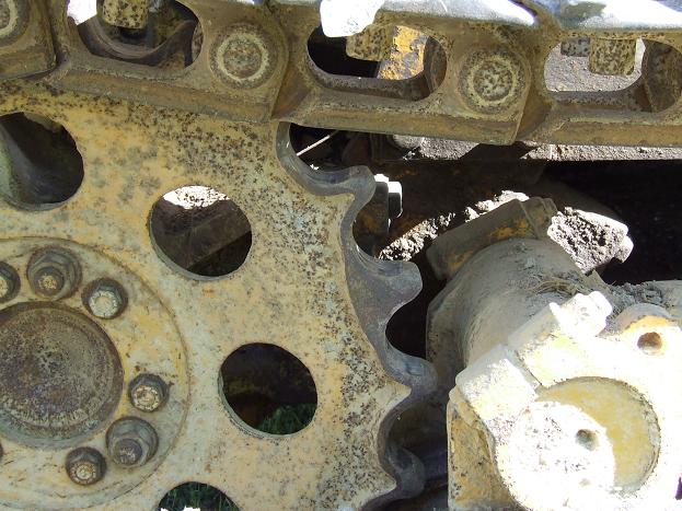

This is the right side sprocket. I know the left side is gone, what percent would you say the right side is? I know nothing about the U.C.

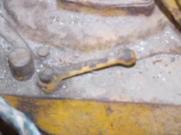

This is a lever to left of the shifter, is this a high/low gear?

The lever is the PTO lever.
The one srocket it trash, the other side harder to tell. It kind of looks like it is thin sideways from rubbing on the back roller, but it is hard to tell.

Are sprockets hard to come by, or can I rebuild this one? If the roller is rubbing on the one sprocket how do I prevent any further damage, and what should the width measuremnet of the sprocket be? It also is hard to crank, it a takes a shot of ether even when it has run for a while.

Those sprockets are obsolete from all sources, used is your only hope, and that is not much better. I think I have one decent set, and one thin set left, that is it.

Check the bearings in the final drive, if the sprocket is rubbing, then the bearings are out, fix it before using it any more.
