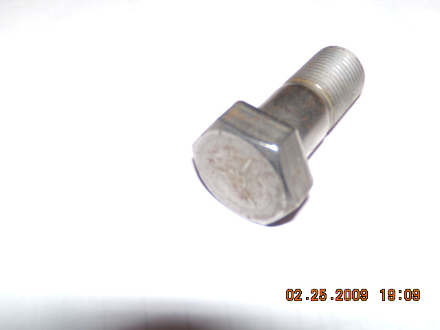

If you want the factory John Deere bolt in the picture, they are readily available from Deere, pary number T11297 for $1.63 each. I buy the same bolt, sometimes full thread, sometimes not, by the case at a local hardware place for $.59-$.99 per lb depending on what kind of sale they are running.
As to the nuts, as I stated earlier, they were a standard pinch style locknut with what would look like a radius on the top. They are currently obsolete as far as Deere part number, but can be bought at any good bolt supplier. Deere never used a square track nut on the two cylinder crawler, it is pointless, as there is no relief on the link for it to sit in like large crawler rails. I have used them in the past, they hurt nothing other than looking incredibly stupid on these little rails.
There are obviously domed head high grade 5/8" track pad bolts around, but they were never factory installed on the two cylinder crawlers, nor are they needed.

Like I said, I've never bought any of these newer bolts from Deere. The one I posted generically is a Deere OEM bolt for a 350 pad (1/2", not 5/8"). Grade 9

The bolt I showed in the pic is NOS as well, but came from the parts bag with the factory part number for the two cylinder crawlers. While I have no doubt the bolts John is showing are Deere, until I see that style bolt in a Deere parts bag, with a two cylinder part number, I still do not believe that the high grade domed head track bolts were ever used on the two cylinder crawler from the factory. Not that I have seen every crawler in the world, but I have had somewhere past 100 pass through my hands, seen a lot more, and have never seen a rail with domed bolts unless I knew that it had been worked on in the past. I have also had some crawlers come with borderline NOS rails and pads that had the style bolt I show in the pic.
