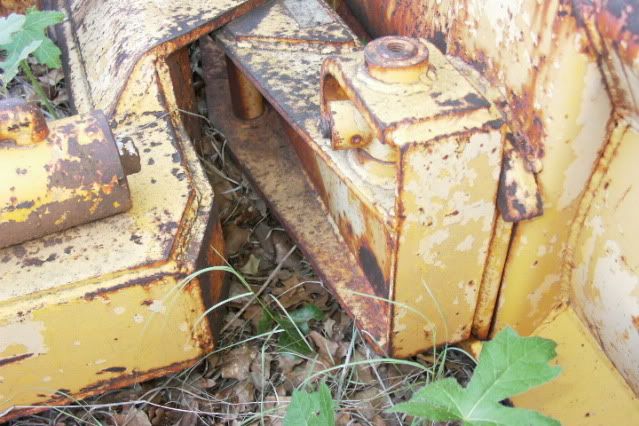

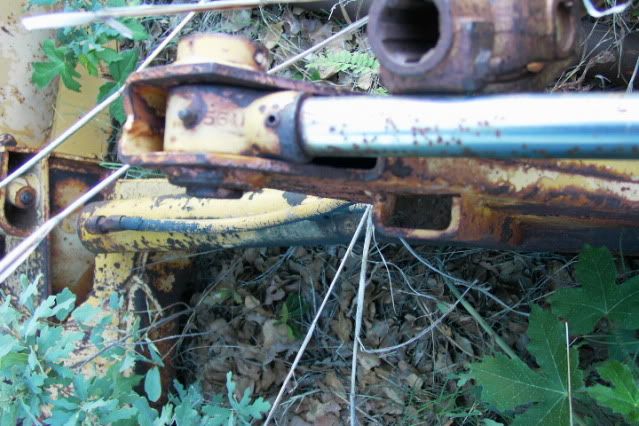

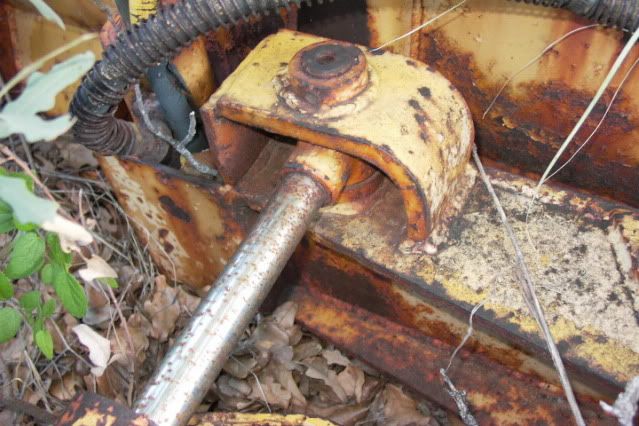

Hopefully I can make these pictures work. The first is my broken end, looking at the picture what I thought was a collar is part of the blade and the roll pin is thru the pin and collar. The set screw is clearly visible and you can sorta make out the threads in the top end of the pin. The roll pin is in line with the cyl rod. Next pic is my good side and the last is one of the blade lift end connections.

Well they did cost me a little, those bright green leaves you see in a couple of pictures, they are "bullnettles"! If you brush against them, even with jeans on, you know about it for hours, and they get well over knee high. I have found nothing that kills them, some 2,4,D mixes will knock them down for a little while, but they come back up. They have a large "tater" a couple of feet down (it looks like a sweet potato), and I have heard if you pour diesel directly on the tater they are done, lotta digin'. I am looking at some stuff Wally-World sells that claims bare ground for a year, we shall see.

Hi!
so next step is to remove the spring pin ( picture one )
then clean thread head of the pin then screw a nice clean long bolt in there with a nut thru a big socket to create a puller and try slowly and gently to pull out the pin and TADA !!! you should be able to remove the cylinder end .

After you clean up the pin's threads as deep as possible, then you screw in the long bolt with the nut already at the shoulder below the head, through the deep socket or pipe coupling or whatever works, as much as possible. To pull the pin, you use the nut against the socket. this keeps the pin's threads intact. If you try to screw in a short bolt against a shoulder, you'll strip the pin's threads - guess how I know.then clean thread head of the pin then screw a nice clean long bolt in there with a nut thru a big socket to create a puller and try slowly and gently to pull out the pin and TADA !!! you should be able to remove the cylinder end .

Let's hope now that my pin has the threads in it. If so, I have sockets large enough and grade 8 bolts that should walk it out of there, even if I need to coax it with heat.
