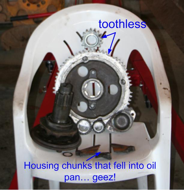

Got all the parts to rebuild the battery-side final drive in my '57 420c.
I'm in this spot because I hit a rock, busted chunks of the housing into the oil pan, then catastrophe ensued. For those of you who like gore... see my busted parts:
I replaced everything in the final drive housing (bull gear, pinion gear, bearings, seals, and the housing too.

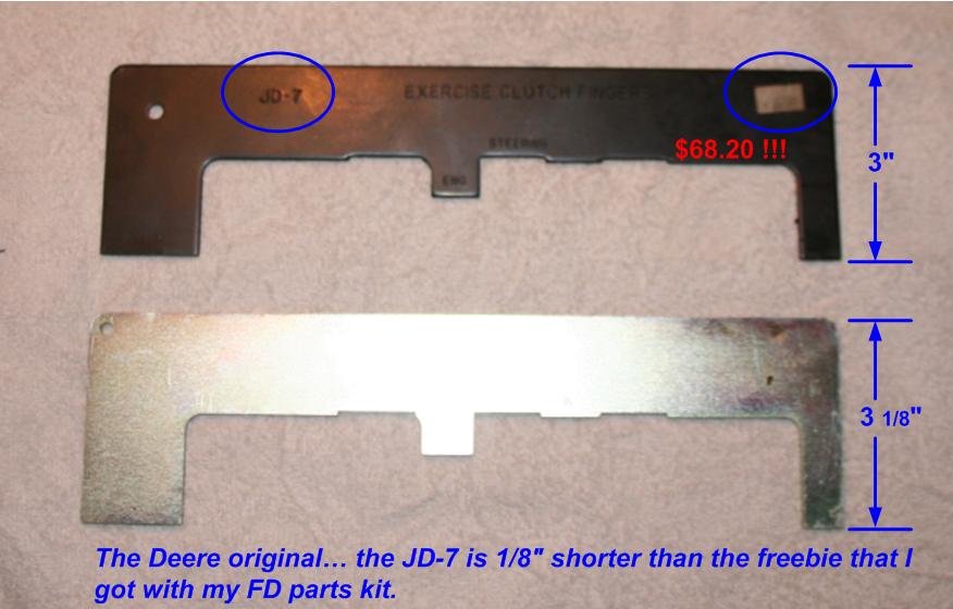

With the parts, I got a freebie clutch guage. Look's like it's been plasma cut from plate stainles, using an original Deere guage as a template.
Now, my brother-in-law (he's got a 40c) pops over with his Deere original guage, stamped 'JD-7', with markings (and a $70 price tag!) and looking all official and stuff.
The two gauges were different. The JD-7 guage will set the tangs about 1/8" farther from the the throw-out bearing than the freebie guage.
See the guages: Image
I decided to go with the Deere original guage. I tweeked the clutch plate adjustment nuts accordingly, then reassembled the whole thing, track included.

My theory is that I should of used the guage I got with the parts.

Post by Lavoy » Mon Aug 27, 2007 10:10 am
Yes my gauges are different from original, they are made that way intentionally. Using the factory gauge, the steering clutch will be extrememly tight and in some situations you will a difficult time getting the clutch to release. Also, when used on the engine clutch, in some situations, you will not be able to remove enough freeplay in the clutch pedal to get the clutch to release.
If you use my gauge, you will need to set the thowout bearing so that the adjustment bolt is just about halfway past the edge of the housing that the bearing holder slides in. I have done well over 100 steering clutches, and using this method, 90% of the time, I do not need to readjust the throwout bearing once the final drive is installed. Not a big deal on 40 and later, but helps on MC's.

Post by Lavoy » Sat Nov 16, 2013 8:38 pm
No, not halfway in the slot, half way past the edge of the casting that the slot is in. It will vary somewhat to greatly from crawler to crawler, but that is a good starting point.
Correct in that you slide the bearing out til it touches the fingers, just be sure to have the steering lever back from the dash the correct distance first.

Post by Lavoy » Sun Nov 17, 2013 11:56 am
Emmett's post is 6 years old, not likely he is following it any more.
No, the 1/8" would not affect it, my gauge is taller, not shorter, so it would be the opposite.
