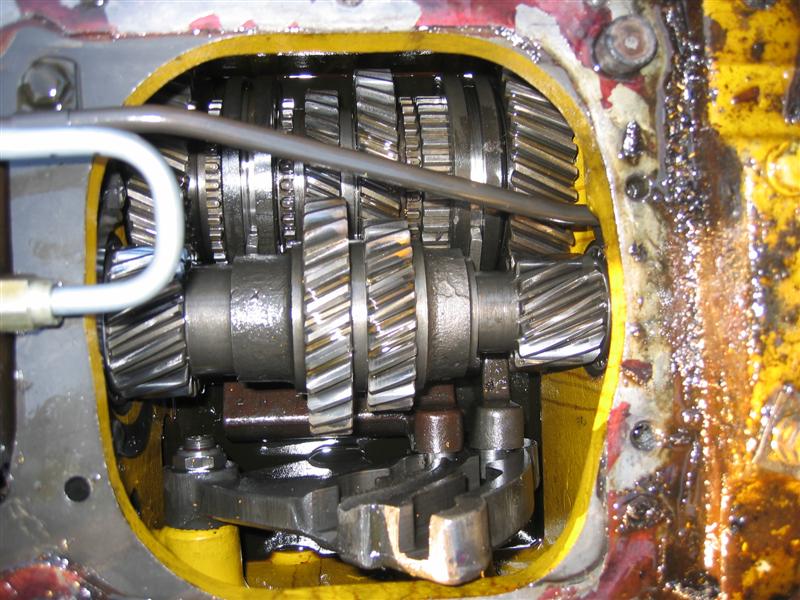

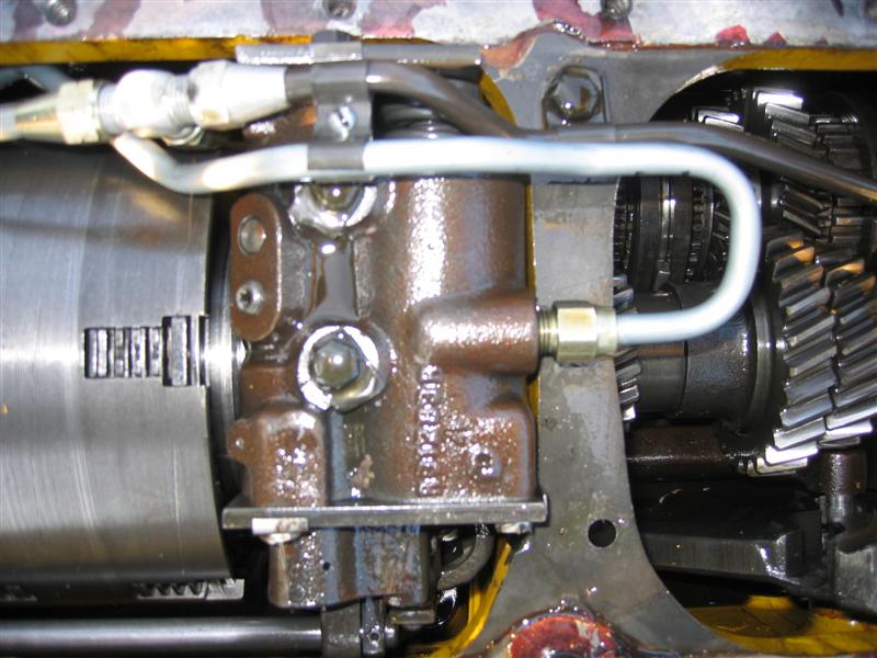

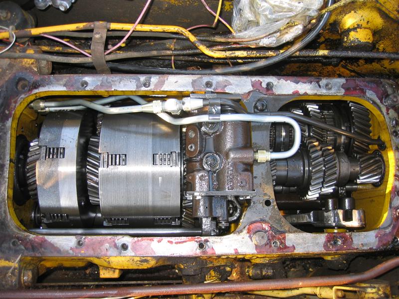

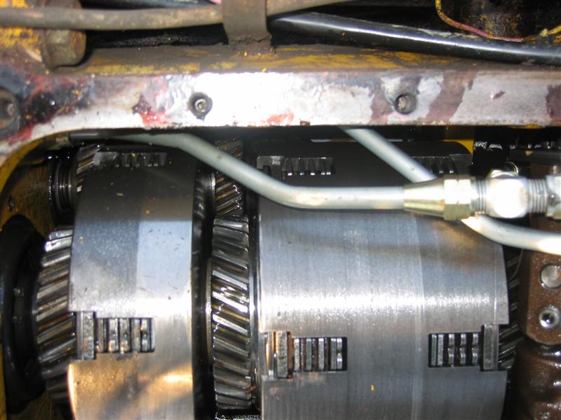

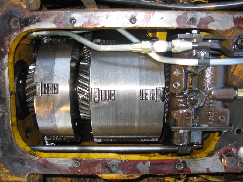

I took the range change top cover off today to have a look inside for something that might be obviously broken. I did not see anything that looked broken. I posted a couple photos of what I saw. The only thing I noticed was that when I took my hand and spun the beveled gear between the two clutch packs (I think the reverse one), it spun freely 360 degrees. If I tried to spin the other two, they would just rock a bit. Is there a key in there that could be sheared off?
This one is showing the reverse countershaft not broken.
