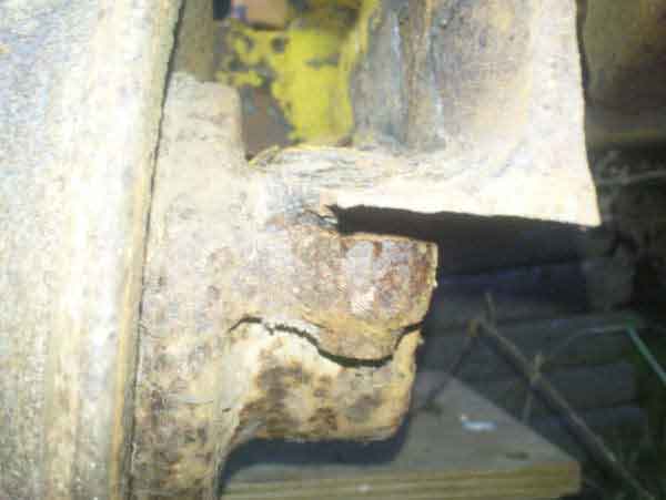

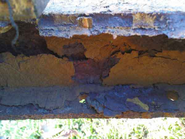

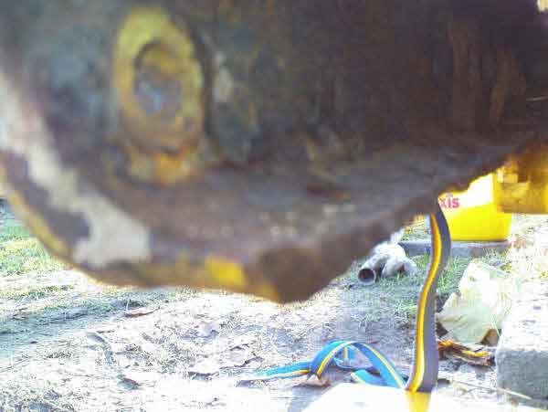

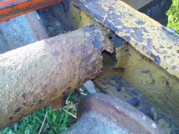

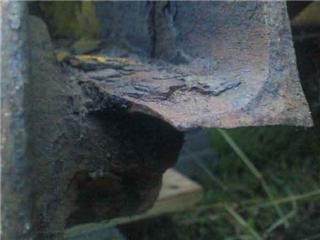

my 350 dozer has bad track frame's. What should I do? weld it up a lot or make new ones? And is any steel suitable or do I need a special kind?
If I need to make new ones? Can i use nuts to bolt the rollers back on, I have no experience in tapping!
There are no second hand frame's available arount here.
And I am afraid that with my outside mounted dozer frame, my track frames wil just break or bend!
(at the end, you can see a little bit of the roller)
( in the centre of the frames)
( it just peels of. the last guy just painted over it)
Just give me some thoughts?

those track frames are gone,if you were in the states you could hunt around for a parts machine or track frames,how many 350's are around in holland,maybe you can find a parts machine.
1010 loader
Post by wwattson » Tue Feb 12, 2008 8:04 pm
I'd have to agree with the assessment that those track frames are not repairable. I wonder if there may be some old 350 parts machines in Germany. I can't image what freight shipping would be from the US but there are plenty of 350 track frames here.

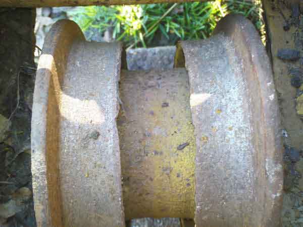

I shure do want a new set of frames. Do i also need new rollers? i know at least 1 of them is broken but are they also worn?
see the crack!!
worn?

If your frames are that bad look closely at your rollers they are probably eaten out at this point with salt or potash what ever they ran in they look good but the plain berrings inside will soon just vanish so just watch them . Lavoy should be able to get a set of 350 crawler loader track frames .Digitup.
