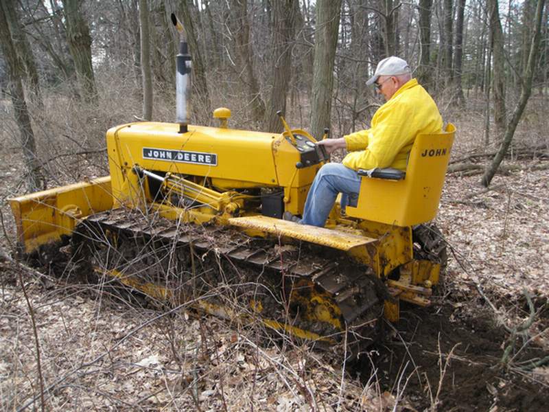

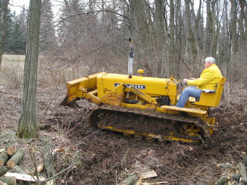

This is my JD 440 IC I just bought. Took her out for some Test and Eval today. That is my Uncle at the controls my certified John Deere expert.
Image[/img]
It was a little muddy but she works good

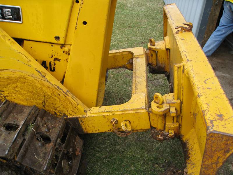

Blade and tracks are like brand new

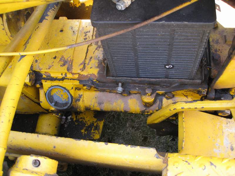

I also found that the hydraulic pumps is leaking out of the side. The gaskets must be bad in there.
I will have to try and find some of them. Can you still get those from deere?
I also found where someone had welded a crack on the transmission case.
I have never seen one of these machines broken here has anyone else? I would think if it were a loader machine it might break here but I was surprised to see this. I am going to take that inspection cover off the tranny today and try to see if there is anything broke in there.
The most interesting thing I found was the gear shift cover. For some reason sombody took and welded a piece of metal over the cover so reverse could not be used. I thought that this machine should be a 5 forward speed 1 reverse speed tranny. I took it off and put it in reverse and she moves fine. I wonder why they did that?
