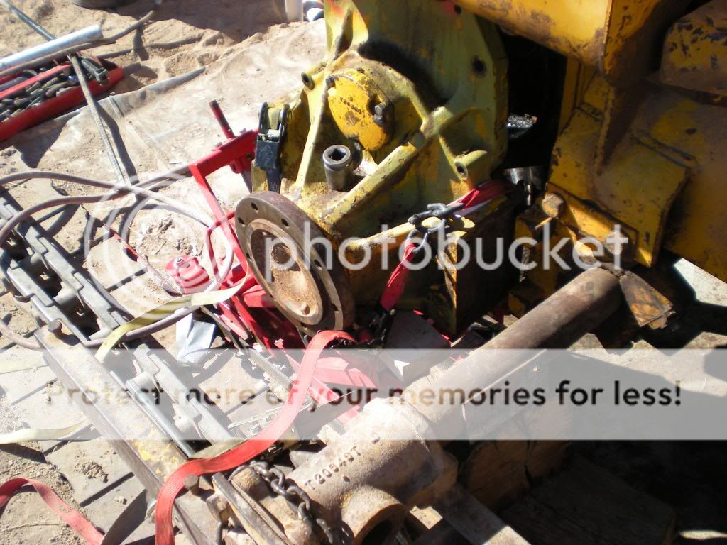

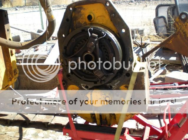

It was easy, the only thing i should have done was remove the final pan first. I had to use a comealong chaining it to the back the machine an let the jack off to get the pan off for cleaning an inspection. The pinion has a broke tooth. I got 1 0n order. It took longer to clean then to take apart. Image

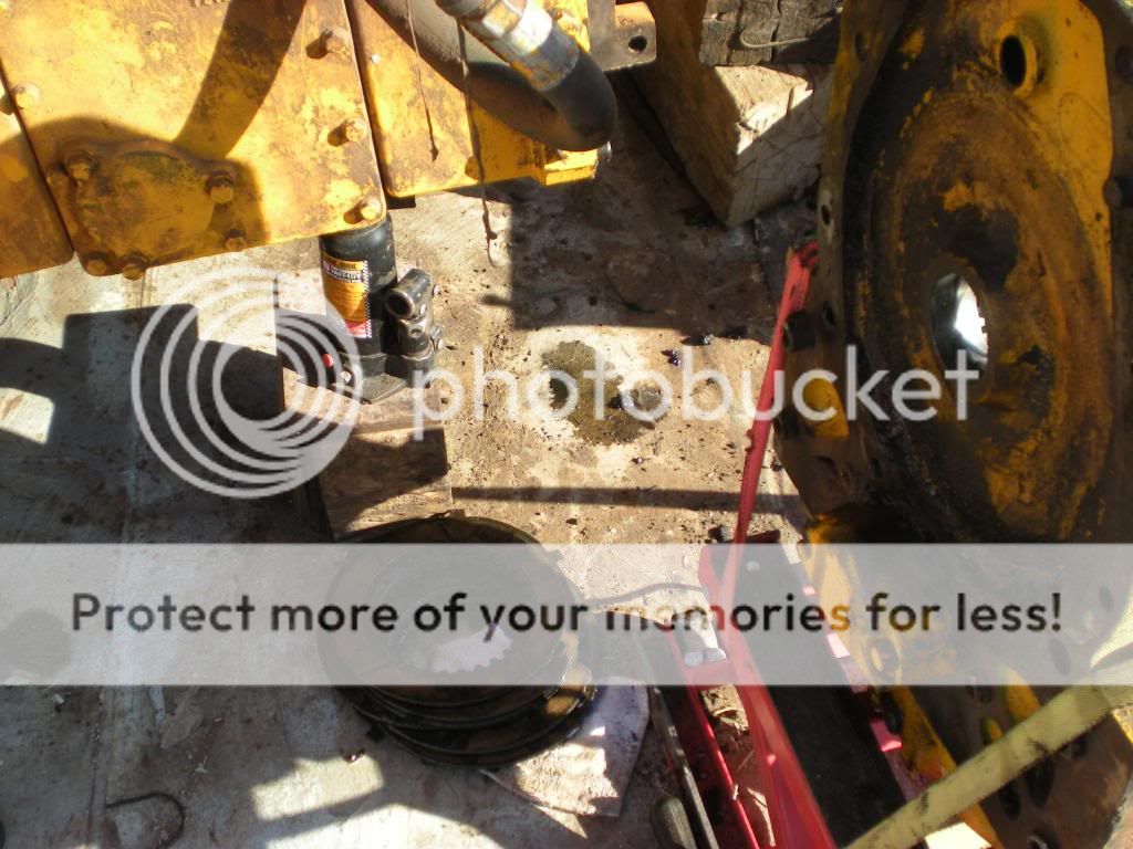

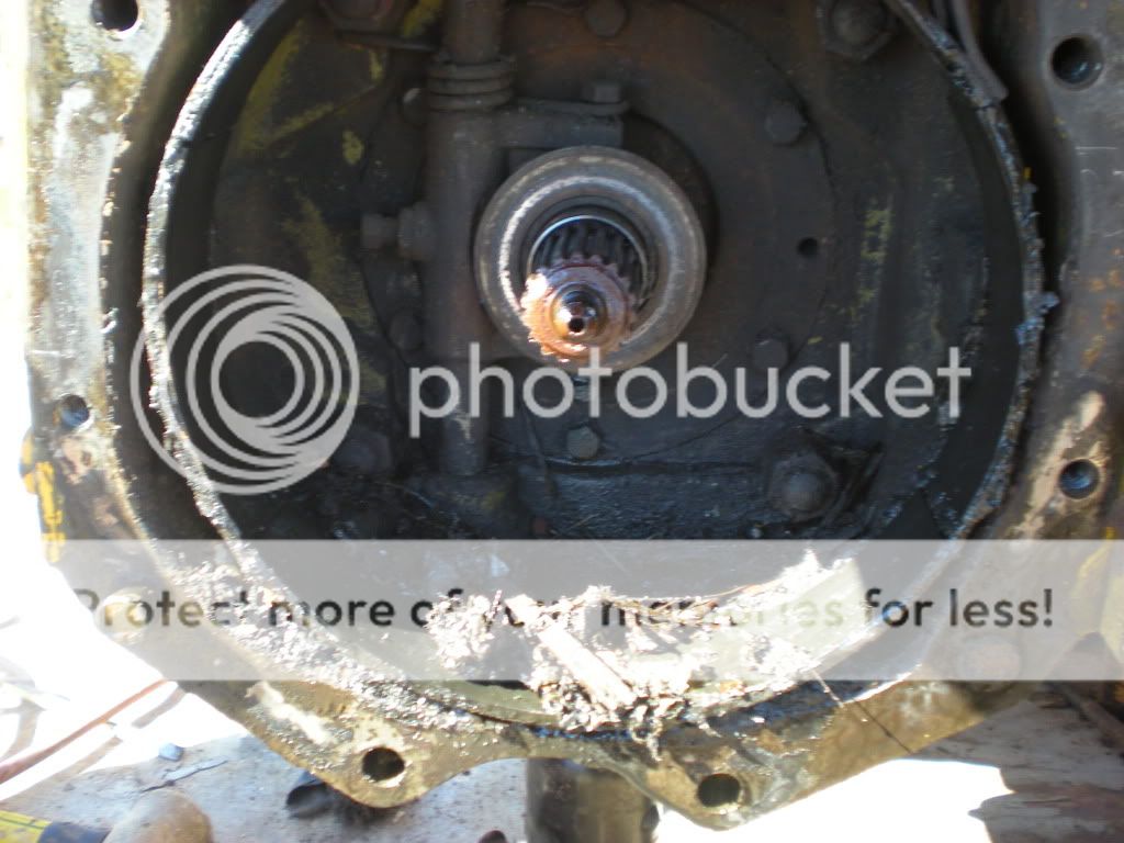

A little bit of trash there I'm thinking that it the proublem.
Someone said its easyer to fix it then trying to clean it an make it work . We have to learn the hard way. Image

Make sure you pull the drive shaft out, it should not have stayed in the rear end like that.
If you don't have access to a steam cleaner, Easy Off oven cleaner really strips the inside of a clutch housing well.
