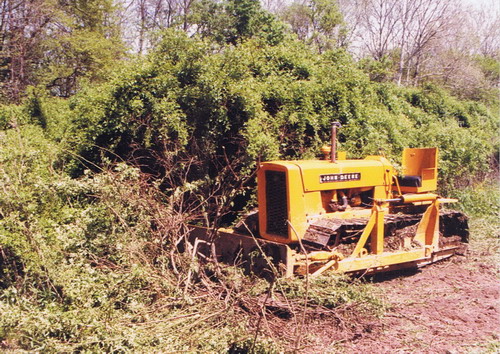

Thanks for the pictures of your grading and tree removal. Looks like you are building a good crown on the road.
