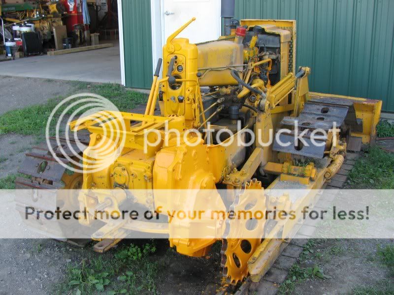

Post by Ray III » Sat Jan 31, 2009 8:32 pm
Has anyone ever used the Old Construction Yellow from Deere? I bought some spray cans and not only were they expensive as hell, the paint would run off if you didn't spend 2 weeks applying 29 dust coats, and when it was actually on there it would just chip off when it got bumped with something.
I gave up on it and took a clutch housing cover (with the new paint) to get real oil paint mixed up in that color. Actually, they screwed it up 2 times and I ended up adjusting the color myself, but damn is it awesome paint.
Do I have the right color? (Instrument panel, top of transmission and seat frame are from JD spray can and clutch and final drive housings are oil paint)

Post by Gil » Sun Feb 01, 2009 8:06 am
Looks like you are coming along fine and have a nice crawler to work with. To my eye, your new paint looks a little more orange than the John Deere color but with the difference variations in color balance in digital photographs and computer monitors it is hard to know.
I am not a restoration perfectionist since I use my crawlers and they are lucky to get paint at all. I have started to use Tractor Supply's "Transport Yellow”. It is cheap and so am I. I would send you $10 for the paint if you would run an experiment for me. If you have a Tractor Supply handy, would you buy a spray can of Transport Yellow and try it on a surface near the correct John Deere paint and take a picture?
Most all of the JD440's I have had were repainted at some point. When I chipped off the repaint, the Transport Yellow seemed to be a pretty close match. With fading and aging it is hard to tell.

Post by CELSESSER » Sun Feb 01, 2009 8:41 am
Ray,
It looks like you have the color about right. The old deer yellow I have gotten is quite orange. And YES the rattle cans "RUNS LIKE A DEERE" if you try to get too much coverage in a pass!

Post by Ray III » Mon Feb 02, 2009 5:22 pm
I thought it was pretty close but a bit on the orange side also. I had bought a small can of yellow to tone it down a little but didn't mix any in yet.
I'll try to remember the Transport Yellow next time I'm at Tractor Supply.
