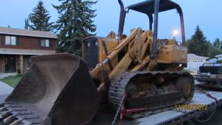

I am ready for the ride in the snow on a melting day! Just need the weather to warm up a bit as it has not been above freezing long enough for the snow to get wet. This 450b is one ROUGH ride.
I have a much better set of pads that will make it onto this loader next summer. I also have a new set of dozer pads but, with all the things I've read hear, I will put the loader pads on.

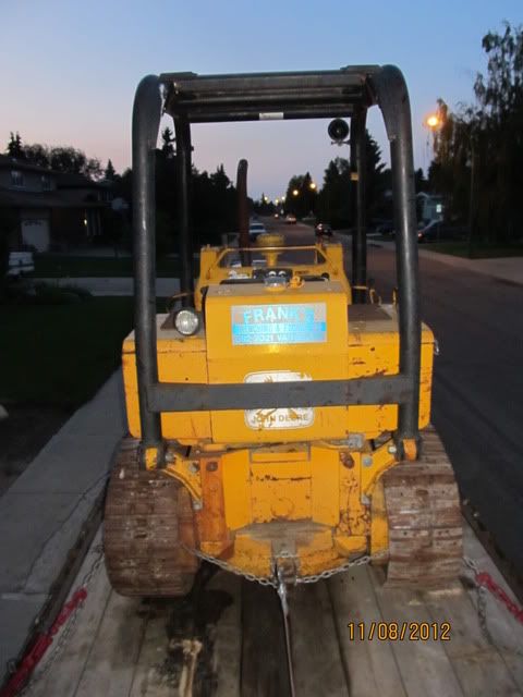

Post by Scottyb » Fri Mar 01, 2013 7:50 pm
Hey Frankdozer, check out the sign on the back of this 450b. I bought it from a woman who was selling the estate. I named the loader "Franks".
I guess it was his first and favourite piece of equipment. It had been well looked after, I can tell you that.
