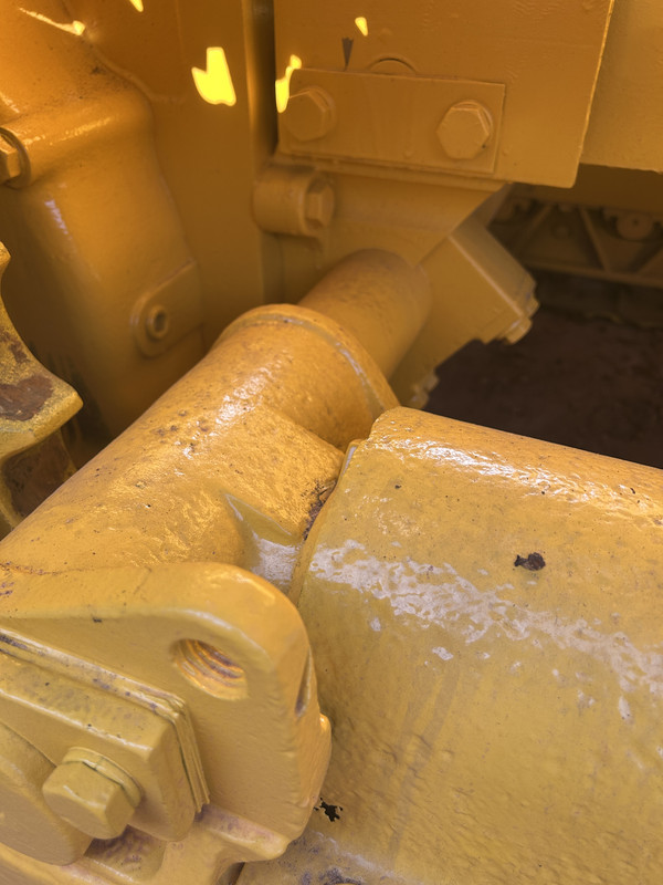

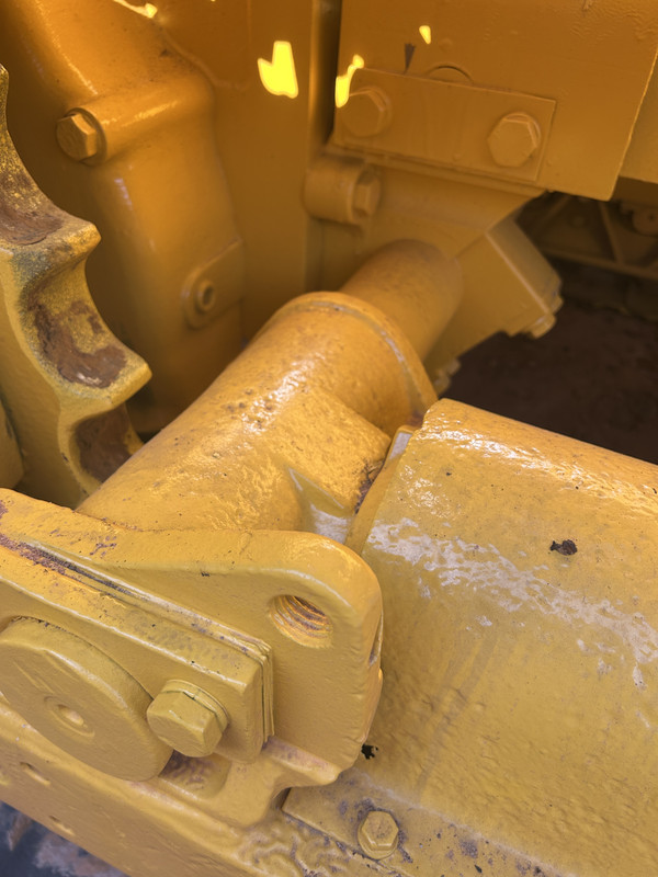

jd 450 is the rear track cross bar bolted or pinned to the machine? it looks like to see the center where theres a bracket on it i would need to drop the belly pan. anyone got a picture of it? i think whatever holds it centered may be broken on my machine. thanks, matt

The rear crossbar is held to the machine by two brackets that have bolt on caps as well as the retainer clips you see at the outer ends.
I don't have any actual pictures of a 450 crossbar. Here is a link to the straight 450 Parts Catalog PC922. You can find the cross bar and parts in it.
The bracket in the center of the bar on the last photo is where the drawbar attaches

btw, i ran my machine for 2 years before i noticed the cap an one of the brackets holding the rear cross bar on was missing. One of four bolts was gone. The other 3 were snapped off, and had to be drilled and tapped. I thought the bolt or pin that holds it centered might be broken , but to check meant removing the belly pan. which looked like .... probably more snapped bolts.
