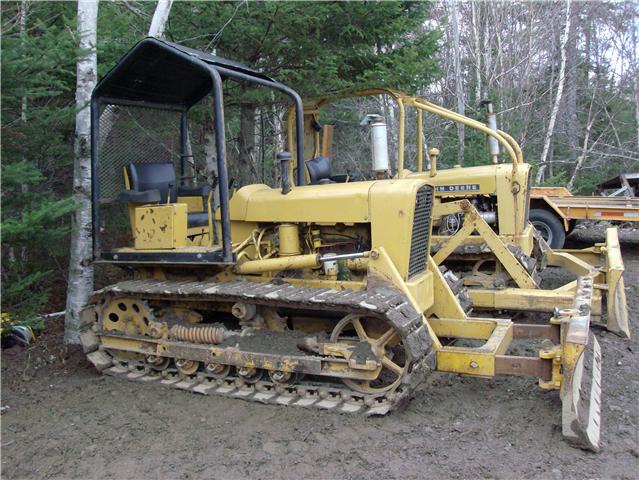

Thanks guys,I found it its the final drives and full of water..... I think its a 1010...I got a pic of it today and will try and post it,if i can figure out how... I Just picked iy up and the guy said it was a 2010, but it sure looks like a 1010. I parked it beside a 1010 my dad has and it looks the same except has smaller blade

Post by shinnery » Thu Nov 13, 2008 9:08 pm
Here it is.
When you are creating the message just click on the "Img" button at the top, then post the location (without any spaces) and then click on the "Img*" button. Usually it works.

looks identical to my 1010c 1965 model good littile dozer that will do alot of work.....

Post by Tigerhaze » Fri Nov 14, 2008 11:25 am
Hi Puttputt-
See my response in your other post, but I too believe it is a 1010 (based on sprocket configuration, spoked front idler, and number of links in track).

I think its a 1010 to, But the guy i bought it from and another older guy thats had equipment said it was a 2010. Then i parked it beside the one my father has and there only a few things different,shifters on the floor,has a narrower blade mounted inside the tracks,other then that its exactly the same... I just want to be sure before i go parts hunting,It doesnt need much .A dash panel is really the only thing missing.other than that its in pretty good shape.
Posts: 11148
Post by Lavoy » Fri Nov 14, 2008 5:45 pm
It is not a 2010 no matter what he says. The difference in the shifters is serial number related, blade width really has no bearing on model of crawler, it is specific to the model of blade.
